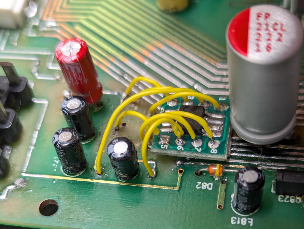

The CD port should be removed and cleaned. In addition to repairing the broken traces, all VIAs in the area should to be reinforced by soldering a thin wire through them. The OP amp usually requires replacement, too.
repaired area with new OP amp
The original OP amp, especially in it's metric size packaging, is no longer available but can be replaced with a standard SMD 4580 dual OP amp from JRC or NJM when carefully placing it on the existing connection pads.

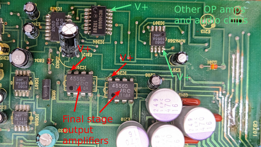

A previously repaired radio, working fine for a maximum of 5-20 minutes, followed by complete loss of sound. The 10 V supply dropped from 10 V to 3.9 when the audio stopped.
some chips with 10 V supply (V+): IC206, IC205, IC307, IC304 and IC305 (not seen above)

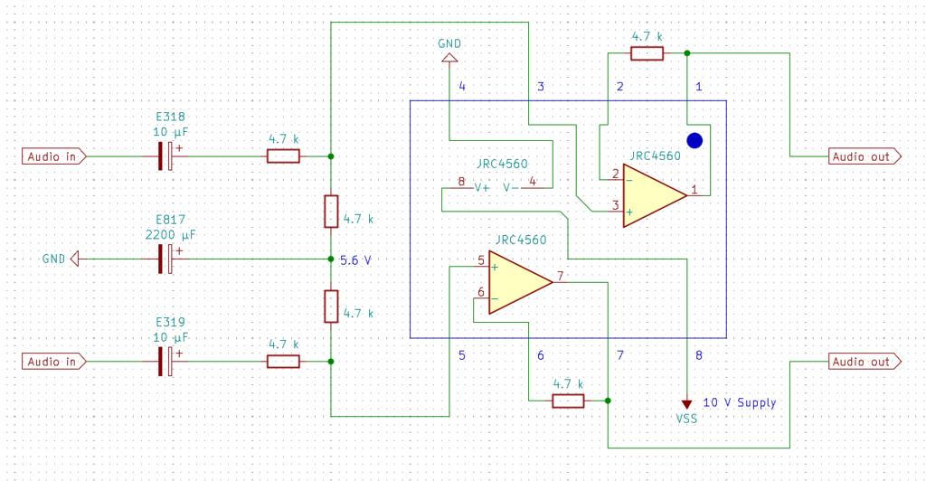

Most operational amplifiers on the PCB depend on 10 V and a drop affects the whole audio path. Below circuit shows that enabling the 10 V supply requires battery voltage to be present on the B.T.T. pin as well as +5 V on the PCNT pin of the main flex cables. The voltage is created by the Zener diode ZD807 and needs to show a correct 10.8 V when the radio is switched on.
10 V power supply switching and routing

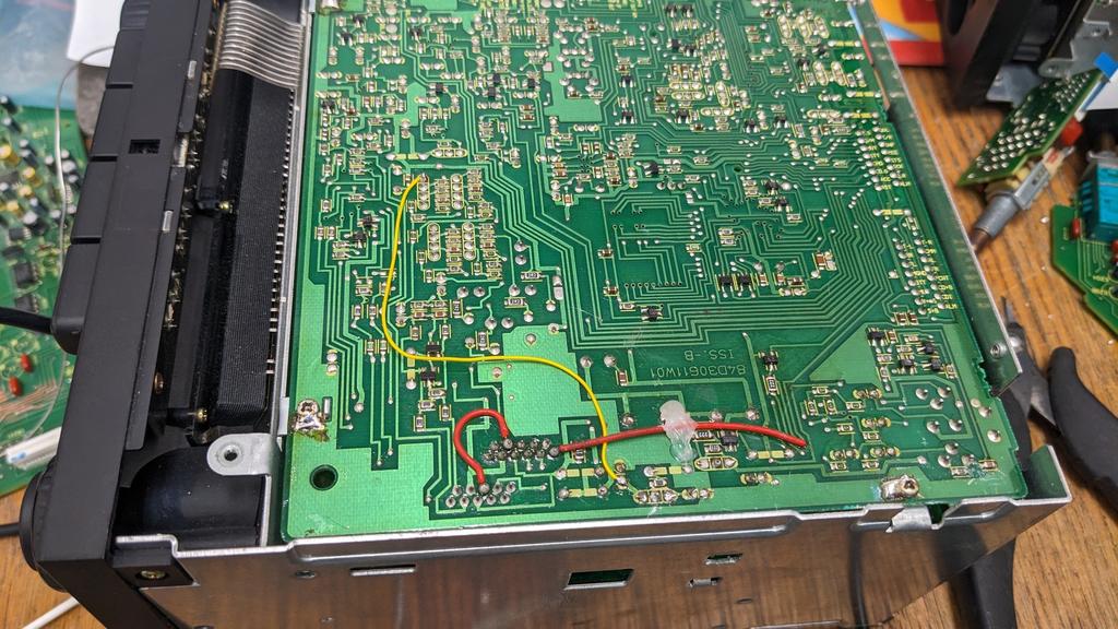

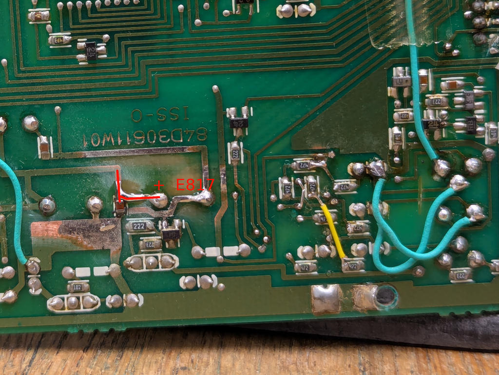

A broken trace caused the voltage not to reach the amplifier chips. Below (yellow) repair trace connects the output of ZD807 to V+ of IC205 and restores full functionality.
the yellow repair cable restores the 10 V supply
