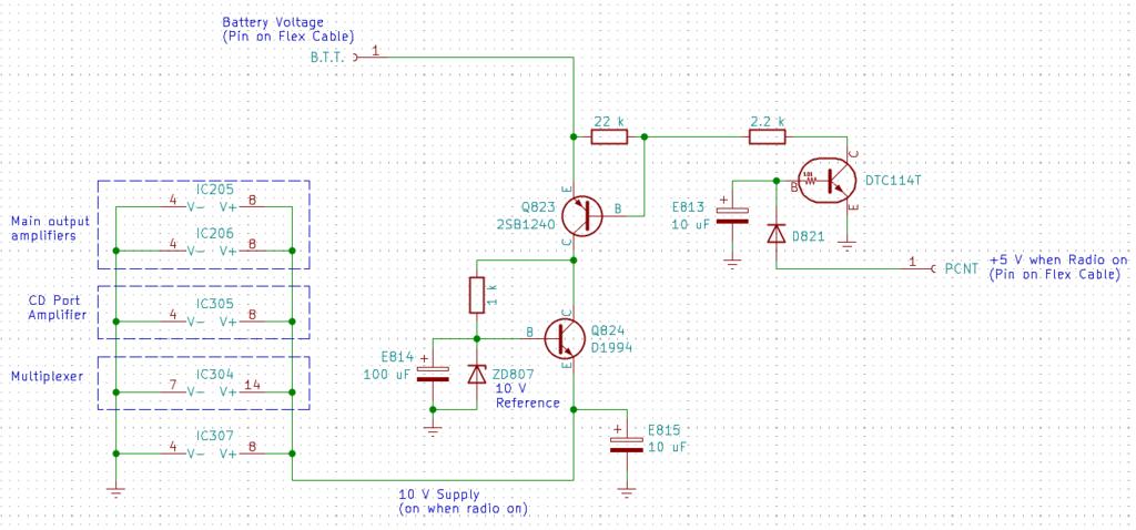

A previously repaired radio, working fine for a maximum of 5-20 minutes, followed by complete loss of sound. The 10 V supply dropped from 10 V to 3.9 when the audio stopped.

some chips with 10 V supply (V+): IC206, IC205, IC307, IC304 and IC305 (not seen above)
Most operational amplifiers on the PCB depend on 10 V and a drop affects the whole audio path. Below circuit shows that enabling the 10 V supply requires battery voltage to be present on the B.T.T. pin as well as +5 V on the PCNT pin of the main flex cables. The voltage is created by the Zener diode ZD807 (ZD801 on USDM radios) and needs to show a correct 10.8 V when the radio is switched on.

A broken trace caused the voltage not to reach the amplifier chips. Below (yellow) repair trace connects the output of ZD807 to V+ of IC205 and restores full functionality.
