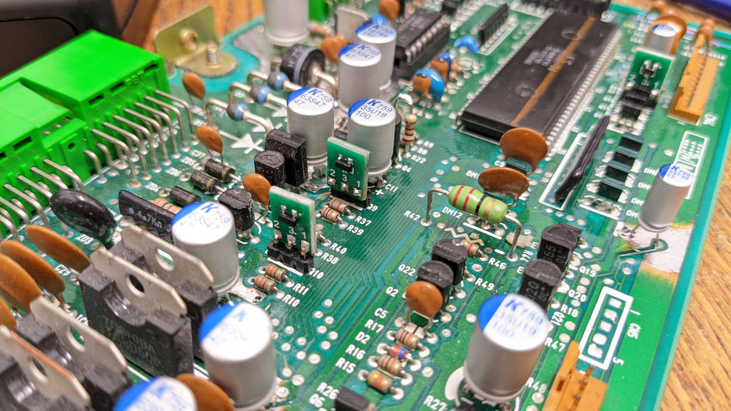

They are NPN transistors with an internal 4.7 kΩ base resistor (NEC A1L3Z). Such parts are no longer available as a direct replacement but still sold in SOT 323 SMD packaging (ADTC143TUAQ) - which requires appropriate adaptation work (SOT23 adapter PCBs):
AC Compressor and Fans not coming on
.. even though they should (AC isn't OFF) can be caused by a faulty Q9 or Q10. This transistor (NEC AN1L3N) is a PNP type with two integrated resistors: 4.7 kΩ (R1) at the base and 10 kΩ (R2) from base to emitter. Same as with Q14 to Q17 there are no drop-in-replacements available any more. A possible SMD replacement is PDTA143X with corresponding adapter PCBs:

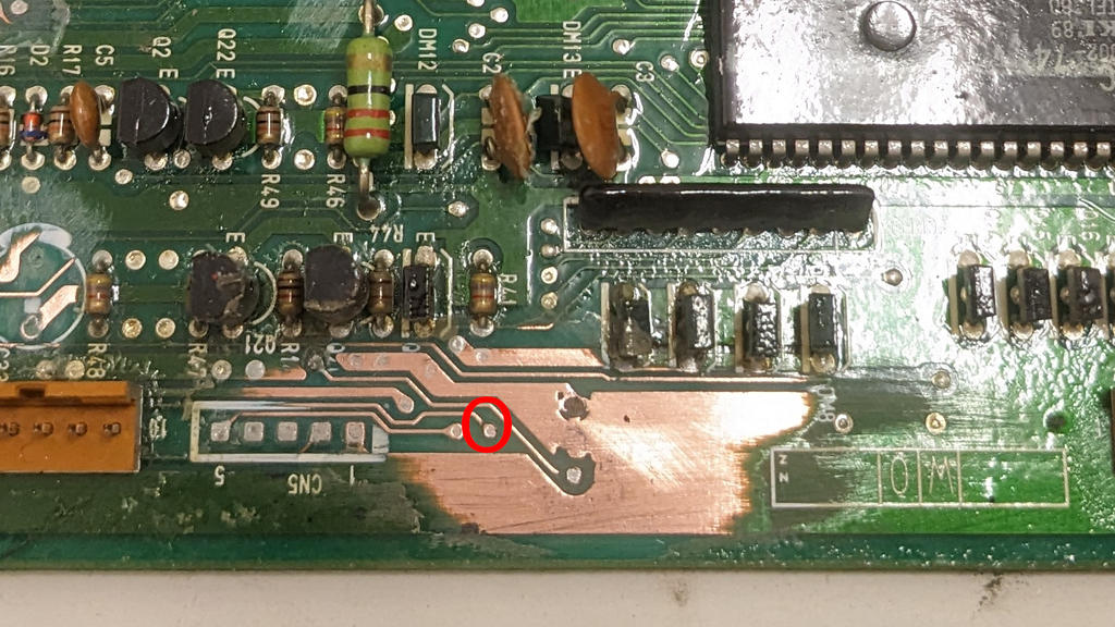

Full functionality but display stays off
If the CCU shows full functionality but the display and LEDs stay off, it could be due to this broken trace near C44:
