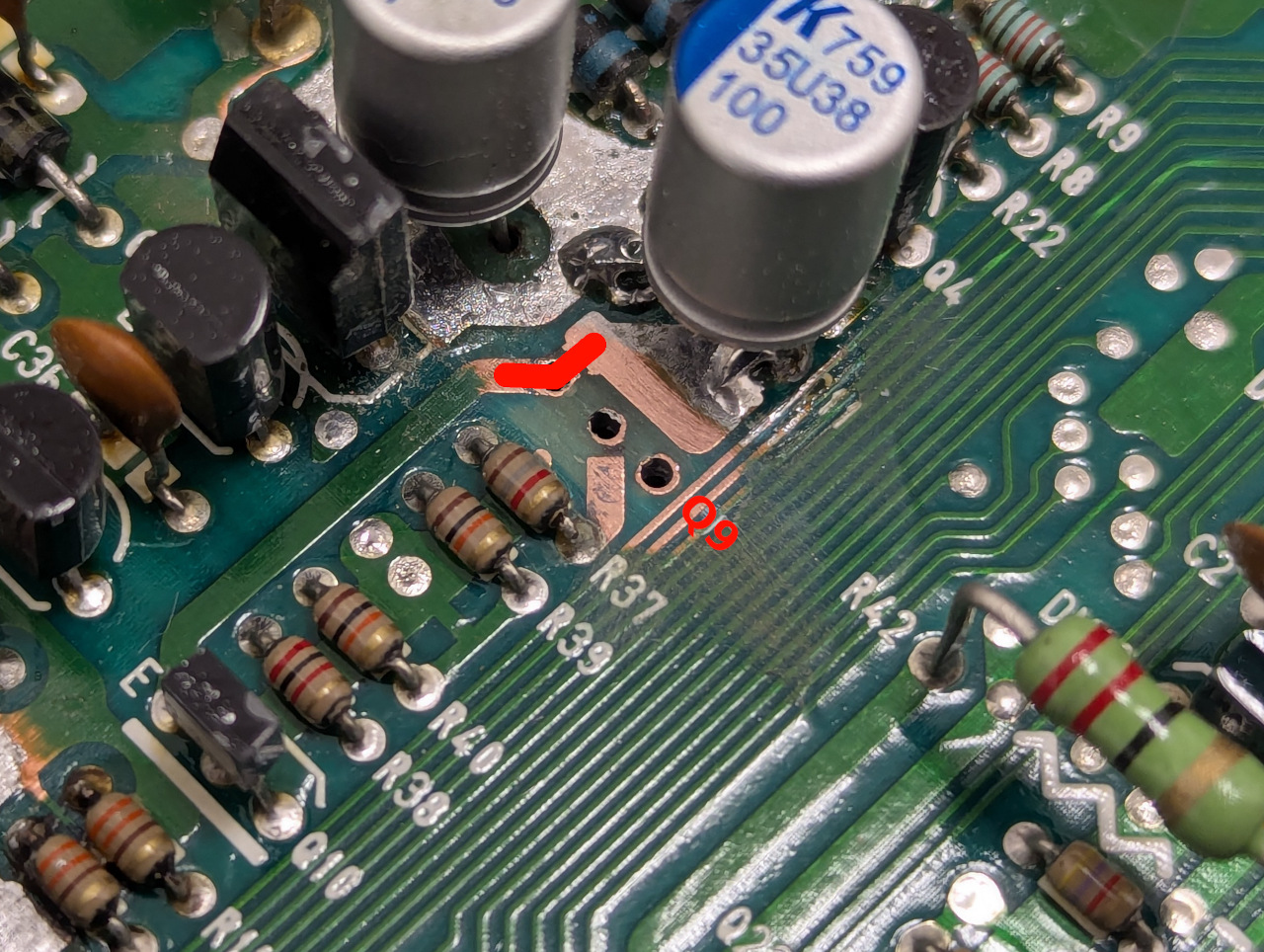

Display stays off, weak beep
If the processor is confirmed to be running (see below) but the display stays off and the confirmation beep is only faint (sometimes completely failing after the first press) the 5 V reference value for the sensor network should be checked. The reference voltage can be measured at pin 12 of the CPU (and others). It runs all around on the outside of the PCB's underside as well and is even found in the small green connector for the vehicle loom.
A too low voltage prevents the sensors from working as well as the beep indicator and the display.
A broken trace near Q9 can cause such a drop in the reference voltage:
