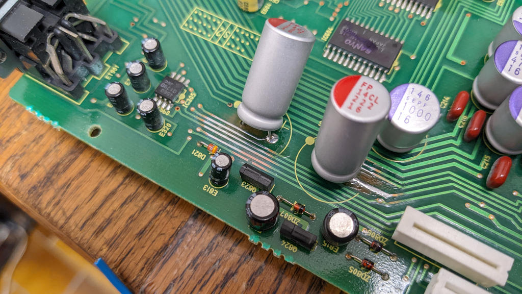

a badly damaged PCB that would not turn on

The two pins previously checked are electrically connected. Measuring the resistance between them should yield a value of <1 Ω. A higher value indicates a broken trace or VIA on the PCB. Often it's the lowermost line from the volume knob flex cable connector to the first VIA:
broken trace hidden under the capacitor's paint marking
