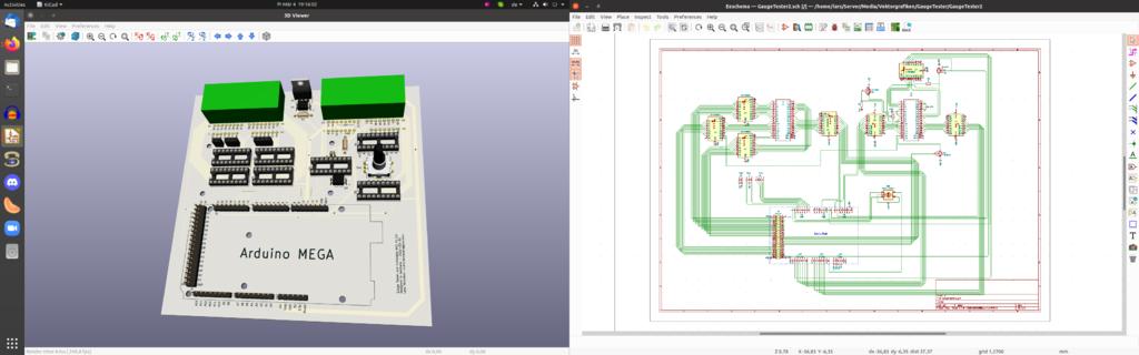

Realization
Localizing the original AG5 connectors and pins as well as a crimping tool - a good option being the ENGINEER PA-20. An Arduino Mega for sufficient output pins and two frequency generators. ULN 2803A (GND) and UDN 2981 (VBAT) drivers to control the cluster. A rotational encoder with push-button functionality to control the tester and an OLED display for a quick response. KI-CAD based PCB design to be used without an extra case.
