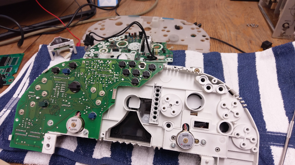

After removal of the cluster from the vehicle it can be examined. First remove the opaque white plastic cover at the back. To do so, unscrew the large black bulb holder by turning it about a quarter of a revolution and pulling it from the PCB followed by removing the cable from its support points. Detach the cover by unscrewing the corresponding screws (don't touch the silver/brass coloured ones yet). Unhinge the cover from the white tabs on the case.
Warning
The silver/bronze coloured screws electrically connect the PCB to the gauges. Removal is of no risk but re-installation is a delicate job with the risk of breaking the gauges.
All bulbs can remain but it might be easier to remove them first - if doing so, note positions and colours. To separate the PCBs from the housing it's necessary to disconnect the cable between the PCBs as well as the trip and odometer stepper motor. This can be tricky as they are a tight fit. A set of pliers is helpful but use with caution.

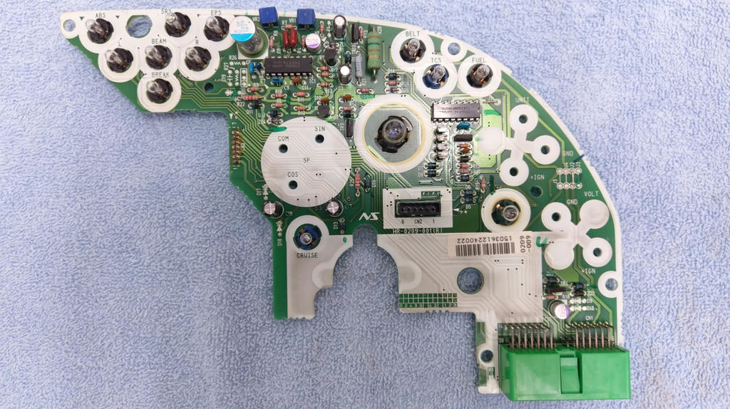

From a soldering point of view, replacing the capacitors on the cluster isn't too complicated. The PCB is standard and there are no large copper areas requiring a powerful soldering iron to get up to temperature.
Before replacing capacitors it's necessary to check the capacitance, voltage, manufacturer series and dimensions. The cluster is mostly equipped with standard capacitors from Panasonic and Nichicon (NHE, KMG and KMA) but also features two Low Leakage (LLA) and two bi-polar (KME series) capacitors.

1991 EU and 1997 JDM AT use the same capacitors at the same places (except C12 on the 1997 JDM AT left PCB) but about half of the identifiers differ. The part numbers in above table can be used for ordering at digikey, mouser and potentially other sources, too.
De-soldering can be accomplished by means of de-solder wick or a de-soldering pump. Using a vacuum unit is more comfortable, but not necessary. Soldering the new parts requires no special tools, a normally sized (~30 W) iron is sufficient.

The most delicate part is attaching the PCB to the housing by means of the silver/brass-coloured screws. They are responsible for the electrical connection of the gauges to the PCB.
Warning
The threads are located inside the gauges and easy to twist-off. Hair-thin wires are attached to them. If a twist-off happens the wires are very likely to snap. This can be repaired but a very delicate task and replacement gauges are expensive. It's best to follow these rules:
  • Insert and rotate the screws with your fingers until they are safely engaged.
  • Use a screwdriver and rotate the screw with two fingertips (not more) until the spring washer just starts to compress.
  • Tighten the screw further until the washer just reaches full compression, a few degrees more at maximum.
After all this has been accomplished the unit can be installed back into the car for further testing.
Check if all lamps light up, backlight is working, RPM and speed values are correct. Please ensure that the displayed speed is not below the actual speed as this is illegal in most countries.
