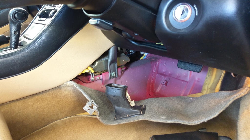

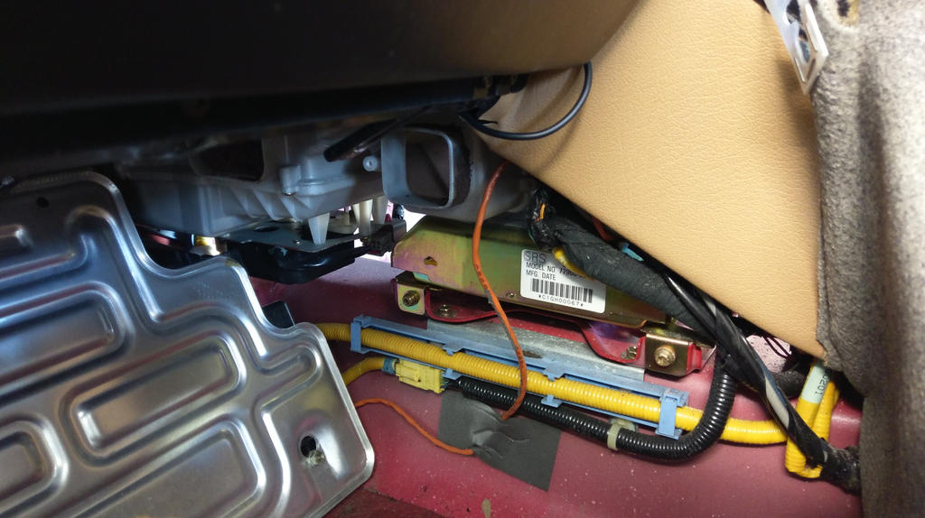

The ECU is located under the centre console and has to be removed towards the right or left hand side of the vehicle - depending on whether it's an LHD or RHD. In case of RHD, the unit is removed towards to the left.
The mounting screws are held in place with strong thread locking compound. Unscrewing them can strip the nut from the inside of the bracket and cause additional trouble.
To avoid this, a small torch (e.g. from a gas powered soldering iron) can be used to heat up the screw to ~100 °C which softens the compound sufficiently and allows the screw to be turned with moderate force. Removal of the yellow connectors is not easy but not an impossible task, either.
located behind the metal bar

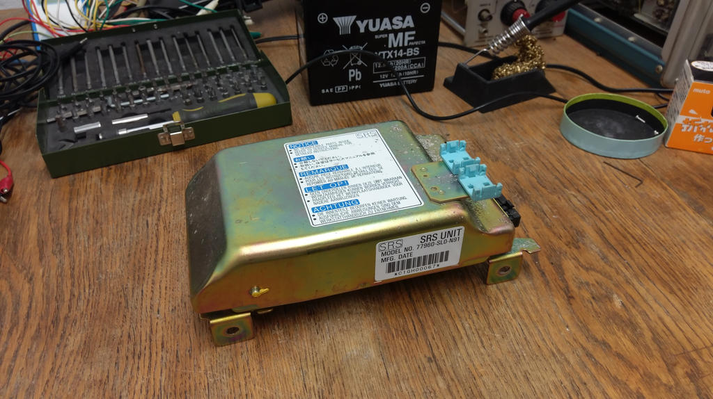

opposite side view
successful removal
Please ensure the ECU is handled with care - the sensors inside are mechanical devices that can be permanently damaged if they experience too much force (e.g. due to dropping the ECU on a garage floor).

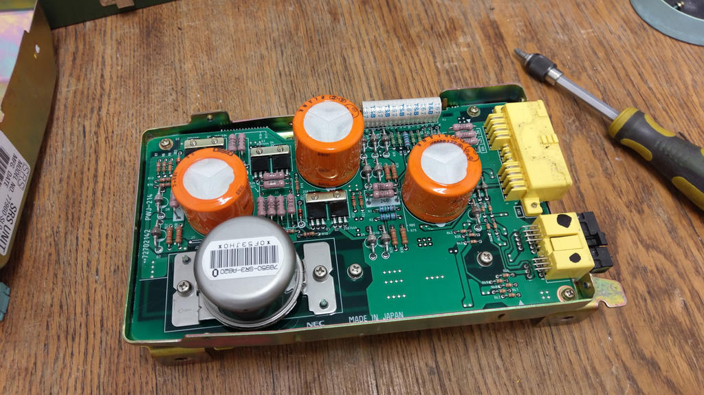

To open the housing remove the corresponding screws. They are secured with regular strength thread locker and can be opened without special treatment. Early build year ECUs can be identified by their single PCB design and the single large backup capacitor. Later years feature a double PCB design and multiple backup capacitors.
Repair
Replacements of the large orange backup capacitors are very hard to source but no leakage has been reported yet. Capacitor replacement is therefore focussing on the smaller size capacitors. For the inspection and repair of PCBs contaminated with capacitor liquid, please refer to the corresponding section in the Climate Control Unit entry.

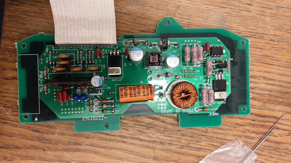

1997 double PCB design
bottom PCB

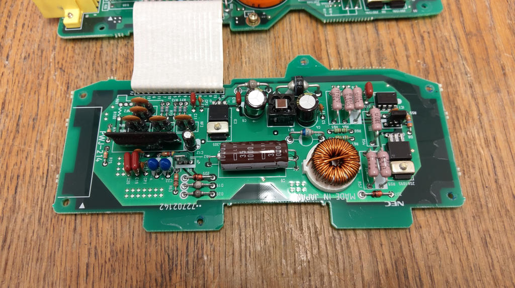

replacements installed
Note that the SRS PCB contains large copper areas and therefore requires a powerful and regulated soldering/desoldering iron for removal and installation of the capacitors - replacement should only be attempted with proper equipment.
Name Replacement Specification - Build Year 1997
C6 EPCOS B41888C7108M000, 35 V, 1000 µF, 10000 h @ 105°C, ↥ 30 mm, ⌀ 12 mm, RM 5 mm
C9, C4 Nichicon PLX1V101MDL1, 35 V, 100 µF, 3000 h @ 125°C, ↥ 12 mm, ⌀ 10 mm, RM 5 mm
C12 Nichicon PLX1H220MCL1, 25 V, 22 µF, 3000 h @ 125°C, ↥ 12 mm, ⌀ 5 mm, RM 5 mm
Dry, Aluminium Polymer Capacitors are suitable for this purpose but hard to source in case of 1000 µF. Above selection contains a regular but long living replacement type. It does not feature the third pin used to fasten the capacitor to the PCB and therefore needs to be securely bonded to the PCB, e.g. by means of Epoxy glue.
