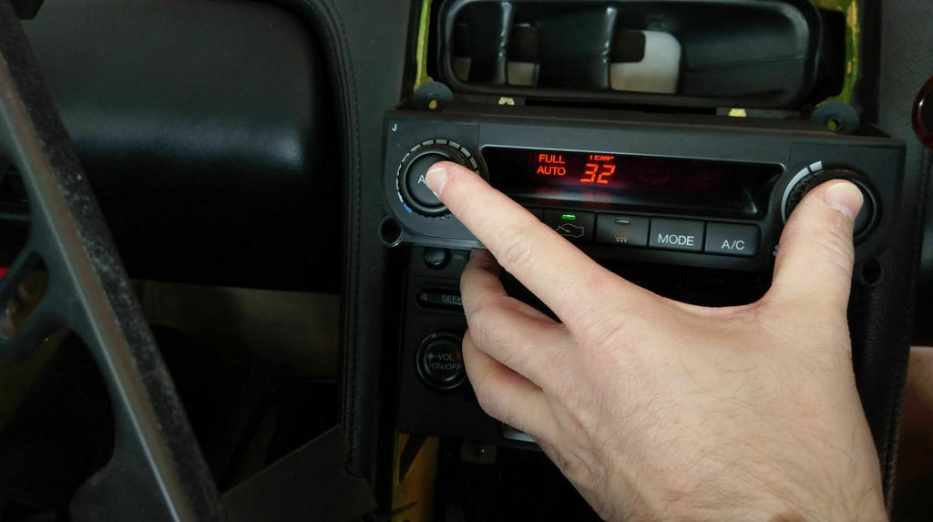

Self Check
Except for the blower motor, above items can be checked by means of a CCU self check feature. It's activated by pressing both the left (Auto) and right (Off) button on the CCU at the same time. Each character on the display (except "FULL", AUTO" and the temperature value) represents a detected fault.
No errors dected
To ensure proper detection (especially for motor related issues) the CCU should be run in full automatic mode, then turn the temperature control from lowest to highest in slow steps. This makes the CCU run all actuators and confirm potential issues.
