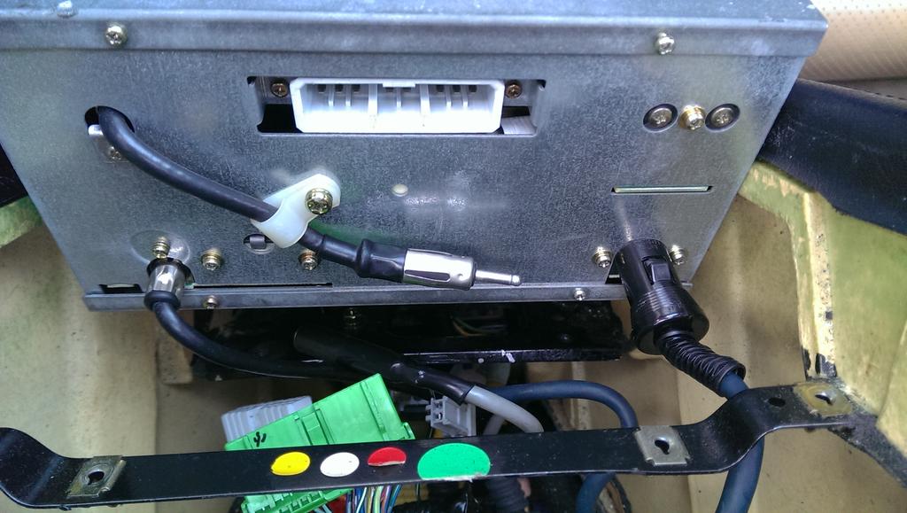

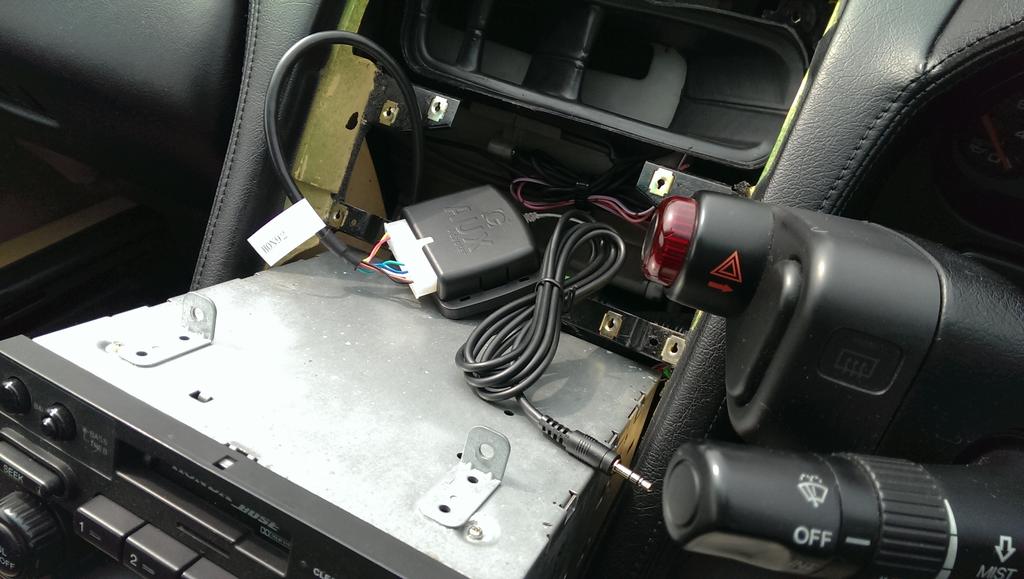

The connecting cable is made out of two parts. The first half runs from the radio to the area behind the seats, the second half the remaining way into the trunk. It's therefore possible to add such CD-changer replacement devices directly to the radio, to the area behind the seats or into the trunk. Depending on the intended use case, each one can be of interest.
For a simple AUX-in device (like the GROM MBUSDA1) connecting it to the back of the radio is probably the best option. For Bluetooth enabled devices without a microphone the area behind the seats might be a good choice.

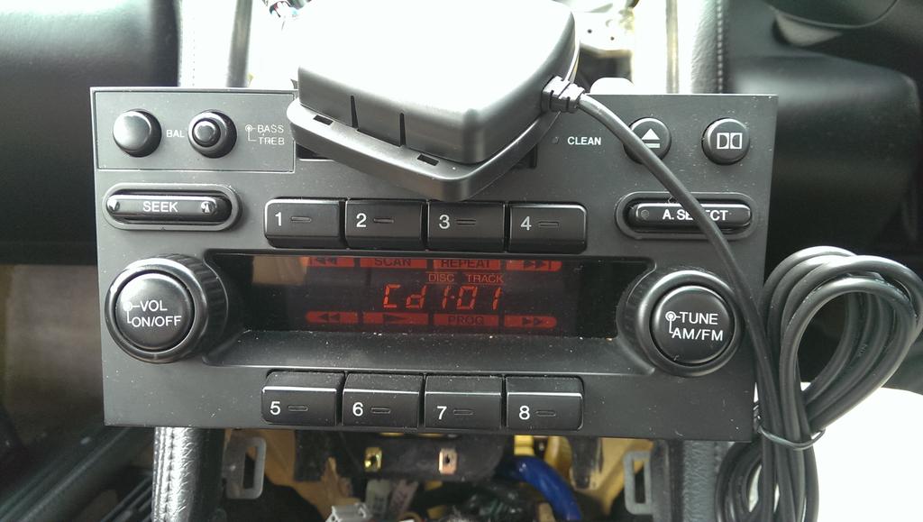

Same as the CD-changer, the devices are powered by the radio. Depending on the type of device, the CD-changer control buttons on the radio can be used to control the connected unit to a various degree. After connecting it, simply pressing the AM/FM button on the radio until the CD-changer controls light up is sufficient.
The resulting audio quality is clearly surpassing Cassette deck or even radio usage and can be considered a true upgrade in terms of audio quality while keeping the center console, radio and speakers in stock condition.
