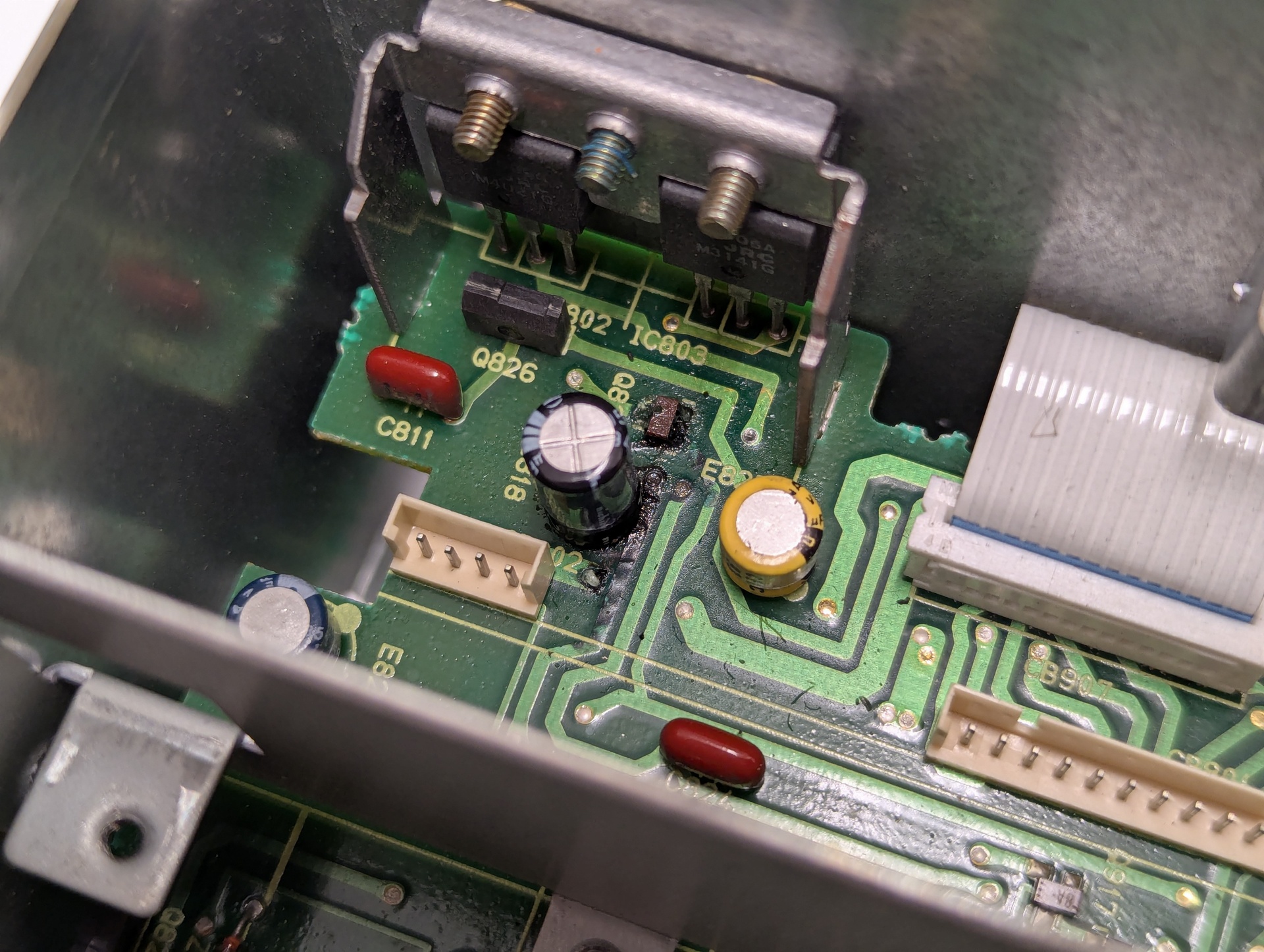

  1. Radio Head Unit - Repair IV
    .. continuation of Radio Head Unit - Repair III
    No display - otherwise fully functional
    Observed on: 1 USDM Radio
    Fixed by: PCB repair
    , parts replacement
    State: Fully understood
    A fully working radio with a non-working display. The display was confirmed OK by installing it into a working JDM radio. An investigation showed heavy leakage by capacitor E818:
    IC 802 is providing 9 V to the VFD heater circuit ...
